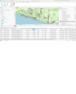

I have attached TableControl in dockpane add-in project. After compilation open ArcGIS Pro. Go to AddIns tab. Select "Show TableControlDockpane" button. Go to catalog pane and select feature class or table. Press Sort button in opened dockpane with TableControl
