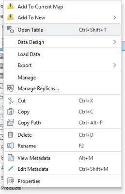

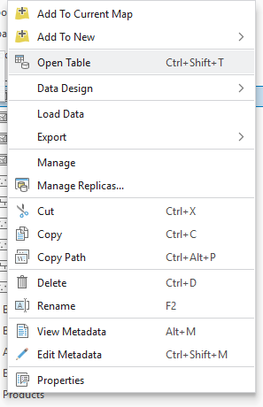

In ArcGIS Pro, I can rigth-click a FeatureClass the .gdb file and select Open Table in its context menu.
When I do this, the attribute window shows the list of rows, and no FeatureLayer gets placed into the map.
This is what I want!!!
Is there a way to do this programatically?   I know there is, because the application, a program, does it.

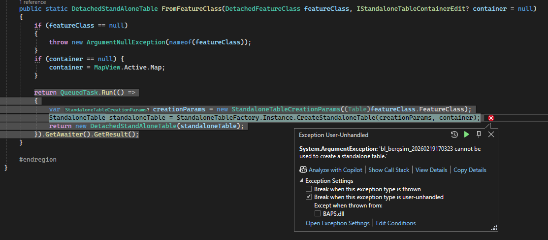

When I try to add the FeatureClass item to my custom table, Visual Studio tells me the featureClass is not a map item.
When I tried to turn the FeatureClass into a StandaloneTable,(which still puts it in the map), I get an error during creation.(co-pilot says it's because my FeatureClass is in a Dataset called __WorkContainer__ and StandaloneTable creation does not trust workspaces that look temporary.  Is this really the case?
