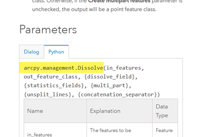

KenBuja
MVP Esteemed Contributor
In my functions to run Geoprocessing tools, it's an async Task and uses await when calling the ExecuteToolAsync method.
Here's an example of one of my functions that uses the Dissolve tool.
public static async Task<IGPResult> DissolveFeatures(FeatureClass featureClass, string DissolveFields, string StatsFields, string OutputName, GPExecuteToolFlags flags = GPExecuteToolFlags.None)
  List<object> arguments = new()
    featureClass,
    OutputName,
    DissolveFields,
    StatsFields
  IGPResult result = await Geoprocessing.ExecuteToolAsync("management.Dissolve", Geoprocessing.MakeValueArray(arguments.ToArray()), null, null, null, flags);
  return result;
//this is how I use the function and the returned result
bool results = await QueuedTask.Run(async () =>
  //lots of code
  path = geodatabase.GetPath().AbsolutePath
  IGPResult DissolvedSummaryResult = await Utilities.DissolveFeatures(JoinFC, StrataFieldName, StatField, $"{path}\\JoinedPointDissolve", GPExecuteToolFlags.None);
  if (DissolvedSummaryResult.IsFailed)
    // do something if it fails
    return false;
  using FeatureClass DissolveSummaryFC = geodatabase.OpenDataset<FeatureClass>("JoinedPointDissolve");
  //lots more code
I also notice you're not specifying the Toolbox where ExtractByMask is located in the tool path property. In my code, the tool is in the Data Management toolbox, so I call it using "management.Dissolve". If you look at the documentation for the tool you're using, in the Parameters section, you can see how it's called in Python. To use it in .NET, just remove "arcpy."
