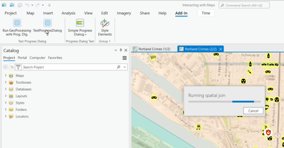

I fixed your snippet above.   I guess the main issue was that the  CancelableProgressor parameter for ExecuteToolAsync is missing.
    protected override async void OnClick()
      var done = await ProcessSpatialJoin(@"Crimes", @"Portland Precincts", @"C:\Data\Interacting with Maps\Interacting with Maps.gdb\Crimes_SpatialJoin", "50 Yards");
      MessageBox.Show($@"Process done: {done}");
    public static async Task<bool> ProcessSpatialJoin(string target_feats, string join_feats, string output_feats, string search_radius)
      //https://pro.arcgis.com/en/pro-app/latest/sdk/api-reference/topic10957.html
      var progDlg = new ProgressDialog("Running spatial join", "Cancel");
      progDlg.Show();
      var progsrc=new CancelableProgressorSource(progDlg);
      //System.Windows.MessageBox.Show("Progress bar show");
      var environments = Geoprocessing.MakeEnvironmentArray(overwriteoutput: true);
      var parameters = await QueuedTask.Run(() =>
        var join_operation = "JOIN_ONE_TO_ONE";
        var match_option = "INTERSECT";
        var field_map = "";
        return Geoprocessing.MakeValueArray(target_feats, join_feats, output_feats, join_operation,
        "KEEP_COMMON", field_map, match_option, search_radius);
      GPExecuteToolFlags flags = GPExecuteToolFlags.AddOutputsToMap | GPExecuteToolFlags.GPThread | GPExecuteToolFlags.AddToHistory;
      var toolResult = await Geoprocessing.ExecuteToolAsync("SpatialJoin_analysis", parameters, environments, progsrc.CancellationTokenSource.Token, null, flags);
      //// dialog hides itself once the execution is complete
      //progDlg.Hide();
      //System.Windows.MessageBox.Show("Progress bar hide");
      if (toolResult.IsFailed == true)
        Geoprocessing.ShowMessageBox(toolResult.Messages, "GP Messages", toolResult.IsFailed ?
        GPMessageBoxStyle.Error : GPMessageBoxStyle.Default);
      return !(toolResult.IsFailed);
