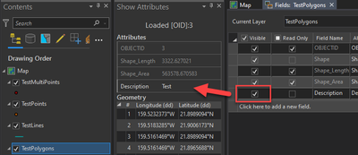

It does look like the Inspector class honors the 'Visible' setting (see Dan's reference above) and hides the attribute column if the 'Visible' checkbox is unchecked.  I implemented an attribute control in my 'Show Attributes' dockpane and changed the 'Visible' checkbox state.  Below the 'Visible' is off and you can see that the 'Description' column is not displayed:
Next i checked the 'visible' checkbox and the attribute column appeared:
