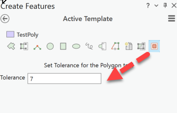

Attached is an addin that creates a Polygon construction tool. This tool implements "ToolOptions". In the Options UI, I added a text box for Tolerance.
Then on the Tool activate callback, I used the tolerance provided in the options UI and to set the map's snapping environment's XY Tolerance like this:
        var snapOptions = Snapping.GetOptions(ActiveMapView.Map);
        snapOptions.XYTolerance = ToleranceToolOption;
        Snapping.SetOptions(ActiveMapView.Map, snapOptions);
