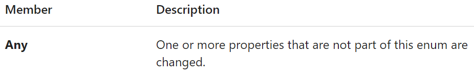

Looking at the documentation here:
https://pro.arcgis.com/en/pro-app/latest/sdk/api-reference/topic12615.html
I see:
This description sounds to me like: “Any is the value you will get when a property is changed that is not specifically represented in the rest of this enumeration. When more than one property is changed that is not specifically represented in this enumeration, you will still only get one EventHint of Any.” If that is not correct or complete, please let me know.
