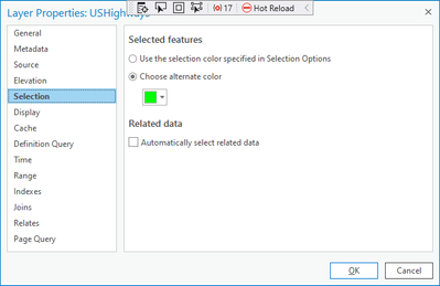

GKmieliauskas
Hi,
There is no possibility to change symbol from ArcGIS Pro.
So, I think, these properties  (UseSelectionSymbol, SelectionSymbol) are reserved for future implementation.
