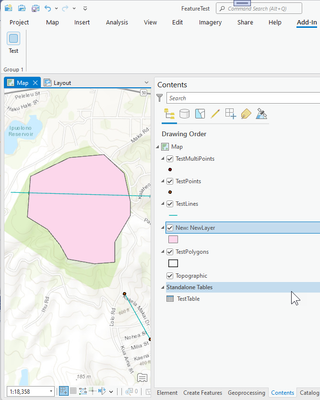

It is working for me.  The following snippet will create a new FeatureClass class "NewLayer" from an existing "TestPolygons" feature layer using the same shape definition but with two new fields.  Then it adds the new FeatureClass to the map as "New: NewLayer" and finally copies all existing features from "TestPolygons" to "New: NewLayer".

My sample code above is for release 3.0 and newer, if you are using ArcGIS Pro 2.x then the API is bit different.   Below is the snippet that works with 2.9, note the change in the copyOperation.Create line required by the 2.x API (the parameters are different):
