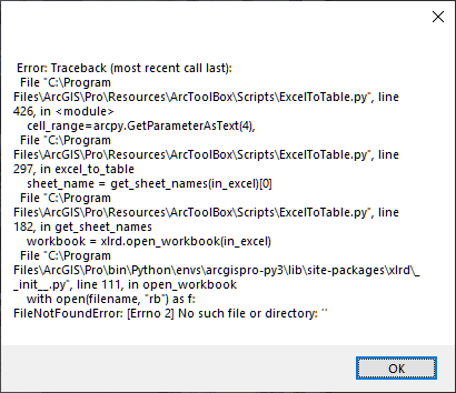

The resulting Python error:
Which makes sense, since I never specified the Input file or output table. But at least this tells me that I am getting the script to start, albeit unsuccessfully.
procStartInfo.Arguments = "?"; // Do I pass the parameters here? If so, what is the syntax?
So in other words, what is the correct syntax for running the ExcelToTable.py script, given the string parameters of InputFile, and OutputTable? Do I use the above property of procStartInfo?
