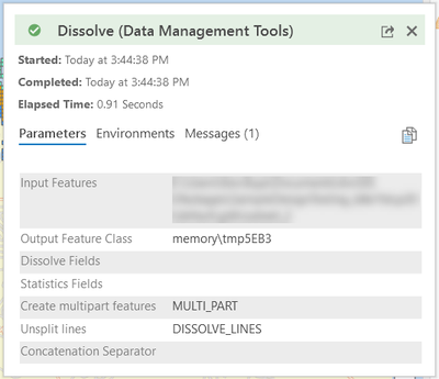

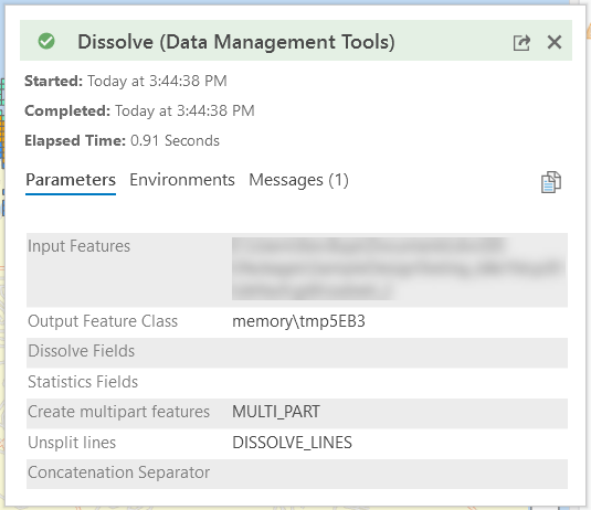

This runs properly the first time, but if I run it again, it throws an error on line 16 when it gets the temporary layer. The layer is created according to the history, but I get the error
 "Could not open the dataset 'tmp5EB3' of type FeatureClass. Please make sure a valid geodatabase or data store has been opened first."
