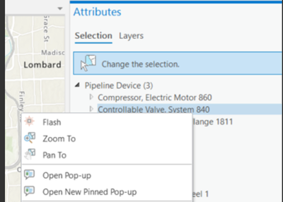

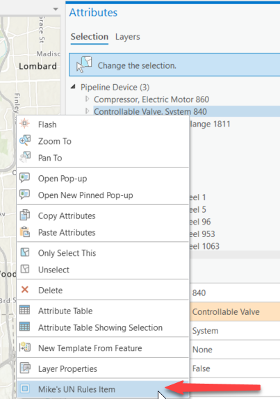

I've added a context menu to the Attributes Pane when you right click on a feature.
Upon clicking on the context item, I want to retrieve attributes from the feature.
Using the screenshot, upon clicking on 'Mike's UN Rules Item', I want to retrieve the Objectid and it's layer name.  Results would be:     840 and Pipeline Device
Does anyone have an example of how to get this information?

Typically with items on a context menus you would use the FrameworkApplication.ContextMenuDataContext property (https://pro.arcgis.com/en/pro-app/latest/sdk/api-reference/#topic10164.html)  and then cast this to an appropriate public API class to retrieve the context object.
Unfortunately in this case there is no public API class in the Editing module that corresponds to an item in the Attributes tree view.   We can look at adding something to a future release to facilitate your scenario.,

Essentially the flash item you see on the context menu is a button (similar to what you have for Mikes UN Rules Item) that obtains the mapMember and objectID of the feature that you right click on in the Attributes pane.   It would then call the FlashFeature API call that you referenced.
So in psuedo code it would be like this
  internal class FlashButton : Button
    protected override void OnClick()
      var context = FrameworkApplication.ContextMenuDataContext;
      var items = context as IEnumerable<AttributeTreeItem_InternalClass>;
      var item = items.FirstOrDefault();
      if (item != null)
        MapView.Active.FlashFeature(item.Layer, item.ObjectID);
So yes it is doing exactly the same thing that you want to do.
The key difference is that the AttributeTreeItem_InternalClass is internal only to the Editing code.  As an add-in developer, you only have access to classes and methods that are in the public API.  Right now, the public API is missing the class used in line 6 to translate from the context object in order to obtain the layer and objectID.
