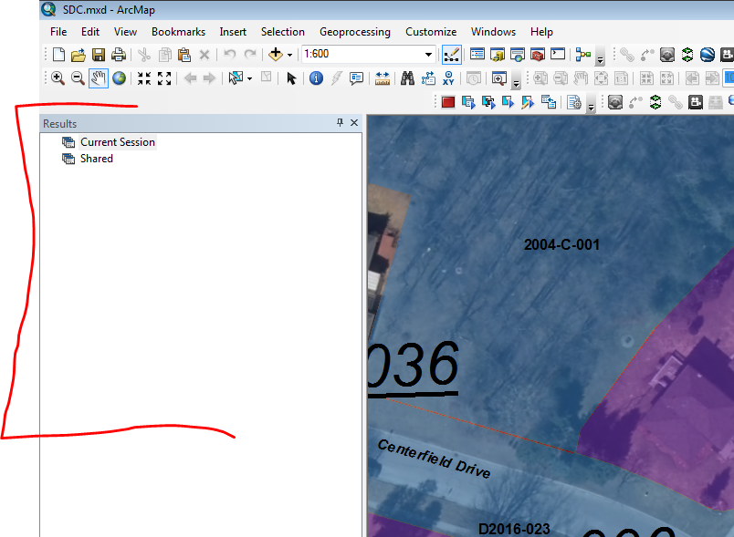

In ArcMap there was the 'Results' pane...see screenshot below.  Is there an equivalent to this for ArcGIS Pro??  I notice that when you run a Geoprocessing Tool, a messagbox will appear that you can click on to get more details.  I'm assuming that this is the replacement for the 'Results' pane?  What is this, and how do I get access to it through the API in order to present custom messages to users as tools are running, or completed running.

I use the History tab of the Catalog Pane, it gets saved with the project and has all of the previous tool runs and messages in it. Hope this helps.
