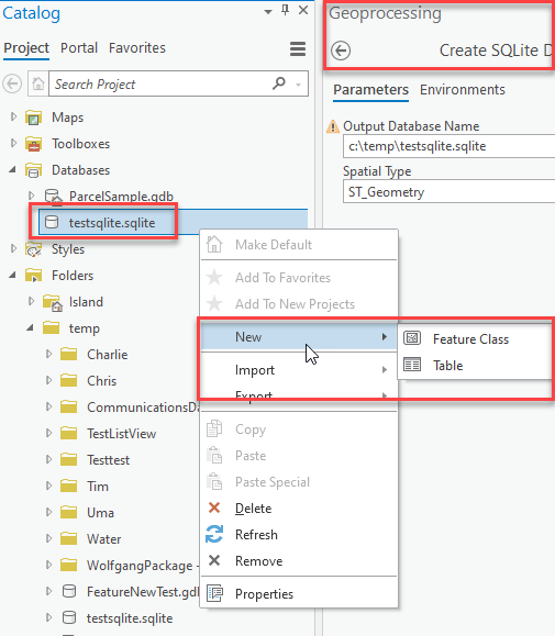

by Anonymous User
Not applicable
That will not work.  You have to create a geodatabase first, which will in essence create stored procedures and functions that aid in creating feature classes and tables in that database.  The instructions on how to create a geodatabase are in the links in my reply above, specifically:  Create SQLite Database (Data Management)—ArcGIS Pro | Documentation
Once you follow these instructions you should then be able to create a feature class (point/lines/polygons) and/or tables by using the right click on the database.   Once created, you can also add the database to your project to make access easier.
