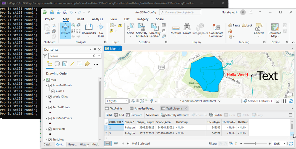

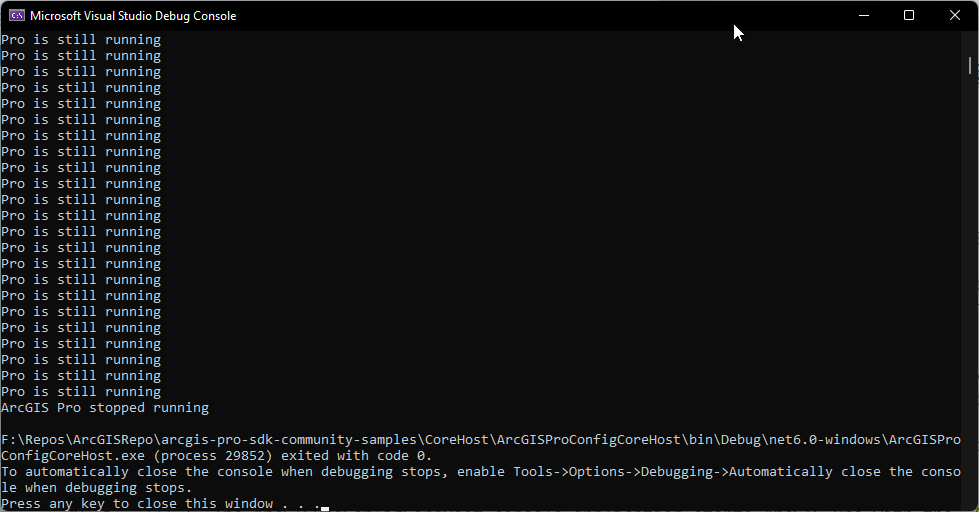

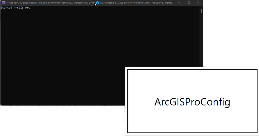

I attached two sample solutions that show how to remote start and remote control ArcGIS Pro from an ArcGIS Corehost application.
This sample is comprised of two samples:
  • Corehost server application that starts and controls the ArcGIS Pro client: ArcGISProConfigCoreHost
  • ArcGIS Pro client application that is started and controlled: ArcGISProConfig
To use the sample:
1. Make sure this project is available: "C:\Data\FeatureTest\FeatureTest.aprx" or change the path in the Corehost application.
1. Run the client application: ArcGISProConfigCoreHost
1. Note that the AppDomain is modified on startup to resolve the Assembly Paths for ArcGIS.Core.dll and ArcGIS.CoreHost.dll by using the ArcGIS Pro installation location.
1. The ArcGISProConfigCoreHost console application starts ArcGIS Pro with the "ArcGISProConfig" Managed Configuration
1. Once ArcGISProConfig has started and is ready, ArcGISProConfigCoreHost sends the project path: "C:\Data\FeatureTest\FeatureTest.aprx" to be opened
1. ArcGISProConfig opens the project
1. Once the output stops press any key to close the application.
1. Close the "ArcGISProConfig" client session (ArcGIS Pro) using the User Interface. Note that closing can be automated as well.
1. The "ArcGISProConfigCoreHost" Corehost application terminates after ArcGIS Pro has been closed.
