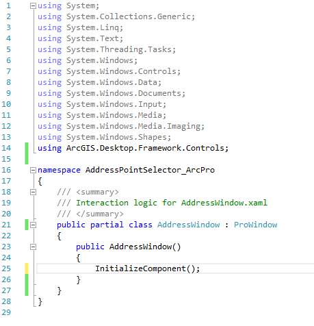

My code is fairly simple.  To open the Window:
To style my Window:
