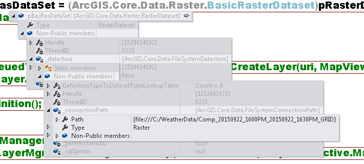

I have tried the rater dataset as a parameter.  The GPResults object IsFailed shows false.  However, when I look at the rest of the parameters of the Results.Messages, it indicates that the GRID I am after does not exist, it appears to ignore the _connectionPath property of the raster dataset.  I checked this during a run and found it be correctly populated.  The ugly screen shot below shows this.
RasterDataSet Properties Screen Shot

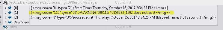

When I execute the geoprocessing Delete tool, and examine the GResults, I see a warning message the GRID I am trying to delete does not exist.  The Delete tool does not seem to navigate the rasterdataset and use the _connectionPath.

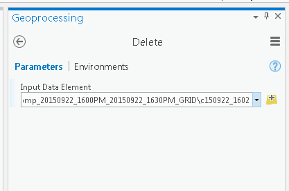

When I look at the tool in Pro, it only calls for one parameter.  The following screen shot depicts this.
Delete Dialog from Pro
I guess the Input Data Element is expecting more than I am providing in my code attempt to execute the tool.
