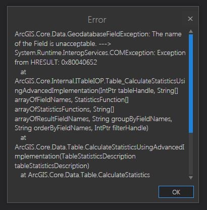

The exception that is thrown on line 14 is as follows:
Error image
Again, it is noteworthy that everything works fine when I set the fieldname on line 7 to any numeric (double) field other than Shape.STLength().

Your assumption was correct.  The dev team for the statistics class(es) is planning a fix for one of the upcoming releases.  It's too late for the fix to make it into the 2.5 release though.

Thanks again Wolfgang. I really appreciate you looking into this. I strongly suspect that it is related to either the dot or parentheses in the field name.
Wolf
by Esri Regular Contributor
