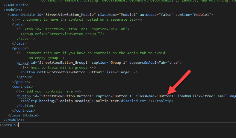

UmaHarano
Hi Dylan
In this screenshot, I see one issue: In the button element defined in the Config.daml,  notice that the className attribute is set to Button1. But in the code snippet you shared above your button class is actually OpenGoogle. So try changing that in the config.daml - to match your button class.
DylanHarwell
That was trick! Thank you for your help, I'm such a noob at this.
