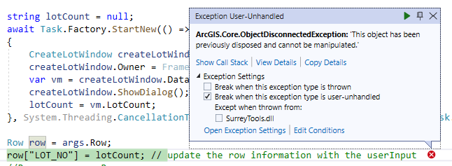

Hello,
I've subscribed my layer to a RowCreatedEvent. I'd like to take some user input from a ProWindow dialog and update the new feature's attributes accordingly. Problem is I'm having trouble preventing the RowCreatedEvent from running entirely before the user has input information. Here's my current OnRowCreatedEvent,
        public static async void OnRowCreated(RowChangedEventArgs args)
            string lotCount = null;
            await Task.Factory.StartNew(() =>
                CreateLotWindow createLotWindow = new CreateLotWindow();
                createLotWindow.Owner = FrameworkApplication.Current.MainWindow;
                var vm = createLotWindow.DataContext as CreateLotWindowViewModel;
                createLotWindow.ShowDialog();
                lotCount = vm.LotCount;
            }, System.Threading.CancellationToken.None, TaskCreationOptions.None, QueuedTask.UIScheduler); // run this sequence on the UI thread
            Row row = args.Row;
            row["LOT_NO"] = lotCount; // update the row information with the userInput

I think the problem is that you can't re-use the EditOperation that is initiating the OnRowCreated event.  Also switching and awaiting threads in a Row event is not really recommended because this can lead to thread deadlocks.

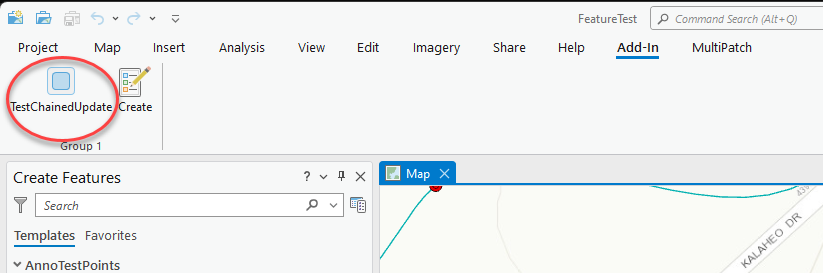

Using the sample add-in i can initiate my event listener using the 'TestChainedUpdate' button:
Creating a new row will trigger the OnRowCreated event, in the event code i remember the object id for the newly created record (for the later update) and initiate the ProWindow ShowDialog on the UI:

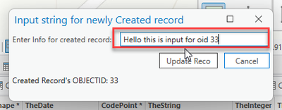

  var prowindowinfoinput = new ProWindowInfoInput();
  prowindowinfoinput.Owner = FrameworkApplication.Current.MainWindow;
  var proWinVm = new ProWindowInfoInputVM
    RecordInfo = $@"Created Record's {Module1.UpdatedObjectIdField}: {Module1.UpdatedObjectId}"
  prowindowinfoinput.DataContext = proWinVm;
  prowindowinfoinput.Closed += (o, e) => { System.Diagnostics.Debug.WriteLine("Pro Window Dialog closed"); };
  var dlgResult = prowindowinfoinput.ShowDialog();
  if (dlgResult == true)
    // user click Ok: update the newly created record with info input data

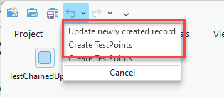

 After i click 'update' in the ProWindow I use Inspector to get the newly created record and update the newly created record in a new EditOperation:
Ideally i would like to use a Chained EditOperation here but i got an error trying to create a chained edit operation.  However, the transaction is on undo/redo stack:
