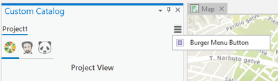

GKmieliauskas
Hi,
I have attached one of your mentioned CustomCatalog project files. You can put it on top of existing file and check it is what you want.
To create new panel use dockpane burger button menu item.
Fell free to ask if something is unclear.
by Anonymous User
Not applicable
Hi,
It looks like your solution adds a new tab, but I would like to replace or cover the content of an existing tab. For example, in the Custom Catalog sample, I would like to click the dockpane burger button menu item and that would replace the content of the current tab with new content. I hope that explains my issue better.
