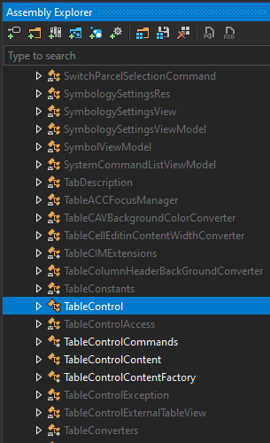

I can clearly see in the Assembly Explorer of Visual Studio 2019 that ArcGIS.Desktop.Editing contains TableControl.

Closing the XAML files and rebuilding the solution helped. The issue remaining is line 17 in the PaneHeaderControlView.xaml
Error: XDG0008 The name "TableControl" does not exist in the namespace "clr-namespace:ArcGIS.Desktop.Editing;assembly=ArcGIS.Desktop.Editing".
