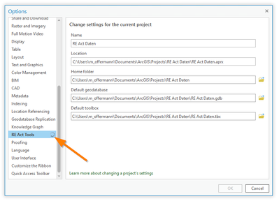

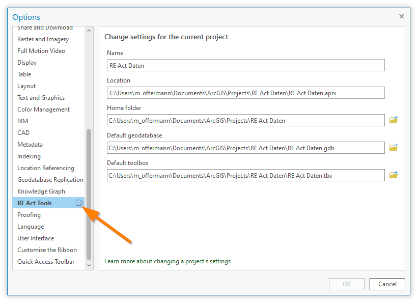

When I install the Add In on the customers machine, and I open the Options dialog, there is a wait indicator which does not stop. My page is never shown. What can be wrong here?

The problem was a Setting of type Date, which had no default value:
After setting a reasonable value, the Options page loaded:
This line of code failed in the InitializeAsync() method:
StartDate = _startDateOrig = Settings.Default.StartDate;
