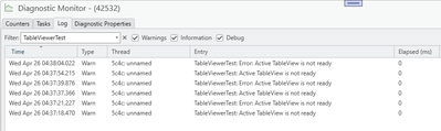

I use a helper method to output my event log info that is prefixing the output string with the assembly's name (i.e. Add-in name):
internal static void WriteWarning (string line) => ArcGIS.Desktop.Framework.Utilities.EventLog.Write
          (ArcGIS.Desktop.Framework.Utilities.EventLog.EventType.Warning,
          $@"{System.Reflection.Assembly.GetExecutingAssembly().FullName.Split(',')[0]}: {line}");
Then I can filter using my Add-in name 'TableViewerTest':
