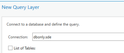

How to get the list of Featureclass names from Oracle SDE connection in .NET SDK just like clicking the List of Tables in below screenshot from New Query Layer dialog box in ArcGIS pro 3.2?
