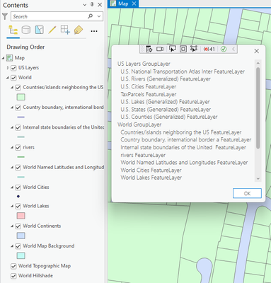

Uma's suggestion works only for group layers, if you want a more general way to traverse the layer hierarchy you have to use the Layers collection of the Map class, as suggest by Uma.  But when you iterate through the layers you need to look at the real type of the layer object (in essence each class that derives from the Layer class) and if the derived type has a Layers collection you then iterate into that sub layer collection.  Below is a sample implementation, however, the implementation is incomplete because it only looks at AnnotationLayers and CompositeLayers as 2nd level entries in the TOC (there are more classes the derive from the Layer class and that have a Layers collection).
protected override void OnClick()
  try
    var mva = MapView.Active;
    if (mva == null) return;
    var layers = mva.Map.Layers;
    StringBuilder sb = new();
    GetLayers(layers, sb, "");
    MessageBox.Show(sb.ToString());
  catch (Exception ex)
    MessageBox.Show(ex.Message);
private static bool GetLayers(ReadOnlyObservableCollection<Layer> layers, StringBuilder sb, string indent)
  foreach (var layer in layers)
    var lyrName = layer.Name.Substring(0, Math.Min(40, layer.Name.Length));
    sb.AppendLine($@"{indent}{lyrName} {layer.GetType().Name}");
    if (layer is AnnotationLayer annoLyr)
      GetLayers(annoLyr.Layers, sb, indent + "  ");
      continue;
    if (layer is CompositeLayer compositeLyr)
      GetLayers(compositeLyr.Layers, sb, indent + "  ");
      continue;
  return true;
