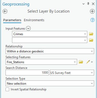

Given these inputs (using Crimes and Fire stations point data sets from the community samples data):
I have this code - as Gintatuatas mentioned I just pass the param values straight to MakeValueArray:

   var parameters =
    Geoprocessing.MakeValueArray(
     input_layer, "WITHIN_A_DISTANCE_GEODESIC", sel_layer, "1000 Feet",
                  "NEW_SELECTION", "NOT_INVERT");
   await Geoprocessing.ExecuteToolAsync(sel_tool_name, parameters);
   //test params by showing the tool dialog
   //await Geoprocessing.OpenToolDialogAsync(sel_tool_name, parameters);
(these are my parameters returned from Geoprocessing.MakeValueArray:)
