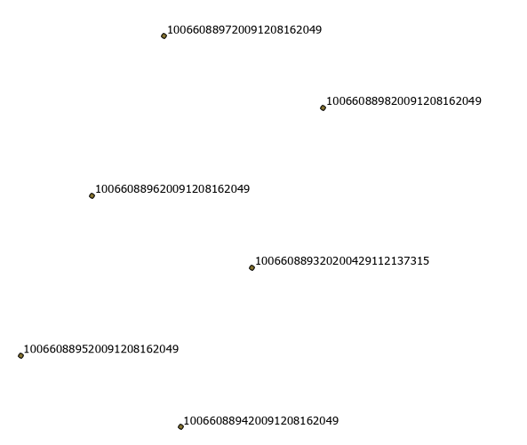

I am trying to label a FeatureLayer with values from an attribute, but somehow it fails. I have calculated the z-value and want to label that, but for some reason it label another attribute.

But its just showing a different attribute (in this case its the objectid)

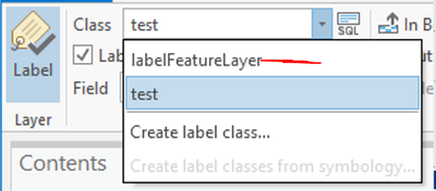

I tried with your code @Wolf but ArcGIS Pro doesn't  show the label.
The label tab dont show the new label class:
But if I manual in ArcGis Pro create a label class (eg. 'test'), suddenly the new label class appires:
Do I need to delete some Label Classes before? Or do I need do to something with 'Class 1'?
