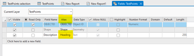

I asked the Report API dev team to take a look at this, however, in the meantime i would recommend using the Alias in the Fields definition:
To hide a column just don't add the column to the CIMReportField array.  To change the order you have to re-arrange the order in your CIMReportField array.  And in order to add all records to your report you need to clear all selected features before you run (export/preview) the report.  If the selected features are not cleared only the selected features will appear in your report.
