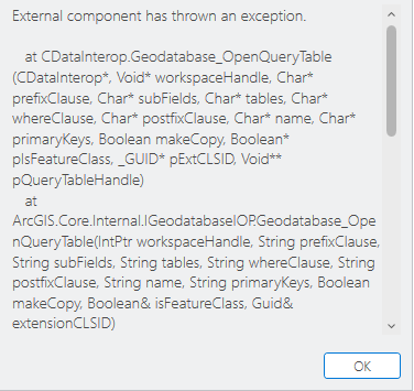

The .OpenQueryTable() method keeps throwing the following error:

I don’t see any obvious issues with the code. To help debug further, could you share how you are creating QueryDef?
The Mobile datastore supports this functionality.
