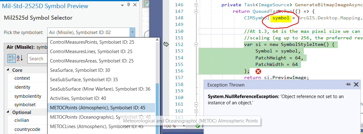

Using Pro 2.7 and data from CommunitySampleData-12-15-2020, when I choose the METOCPoints (Atmospheric), SymbolsetID:45  in the DictionarySymbolPreview sample I get a null reference exception.
I wonder if something's not configured correctly.

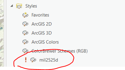

Starting with a fresh MilitaryOverlay.aprx from the zip file, I see a ! next to the stylx:
I clicked and browsed for:
"C:\Program Files\ArcGIS\Pro\Resources\Dictionaries\mil2525d\mil2525d.stylx"
and the ! cleared.
Still get null ref exception though.

Kirk, I dug into this a little deeper.
It looks like, in some cases, particular symbolsets have a "000000 - Unspecified" symbol entity as the default. The Atmospheric symbols - symbolset 45 and 46 as examples. So the initial pick of the METOCPoints, Lines, Polys triggers a search for the default entity: "symbolentity 0". Now, I _think_ the GetDictionarySymbol used to return a default symbol for undefined entities?? - but it could just be a bug in the sample - anyway, when I select a "real" entity from the symbolentity drop down (i.e. something other than 000000 - eg 110100), I get the correct symbol retrieved and loaded.
I think the best thing to do is simply wrap the GetDictionarySymbol call in a try/catch to prevent the null symbol being returned from blowing up the dockpane in those cases where an unspecified "000000" symbol is being requested.
private Task<ImageSource> GenerateBitmapImageAsync(Dictionary<string, object> attributes) {
            return QueuedTask.Run(() => {
              try {
                CIMSymbol symbol =
 ArcGIS.Desktop.Mapping.SymbolFactory.Instance.GetDictionarySymbol(
         "mil2525d", attributes);
                var si = new SymbolStyleItem() {
                  Symbol = symbol,
                  PatchHeight = 64,
                  PatchWidth = 64
                return si.PreviewImage;
              catch(NullReferenceException) {
                return null;
