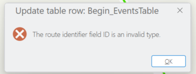

I am running into this a lot. When simply trying to update the values in my FROM_MEAS or TO_MEAS in my table, I get the error.
Everything else appears to be fine with the table. The RouteID field is Long, and my FROM_MEAS/TO_MEAS are both Float.
When I get this error the updates I make in the table do not take, it reverts back. I've noticed though if I save edits and close/open the table and click around a bit, the new values eventually will update but there doesn't seem to be a rhyme/reason/pattern that I can follow.
