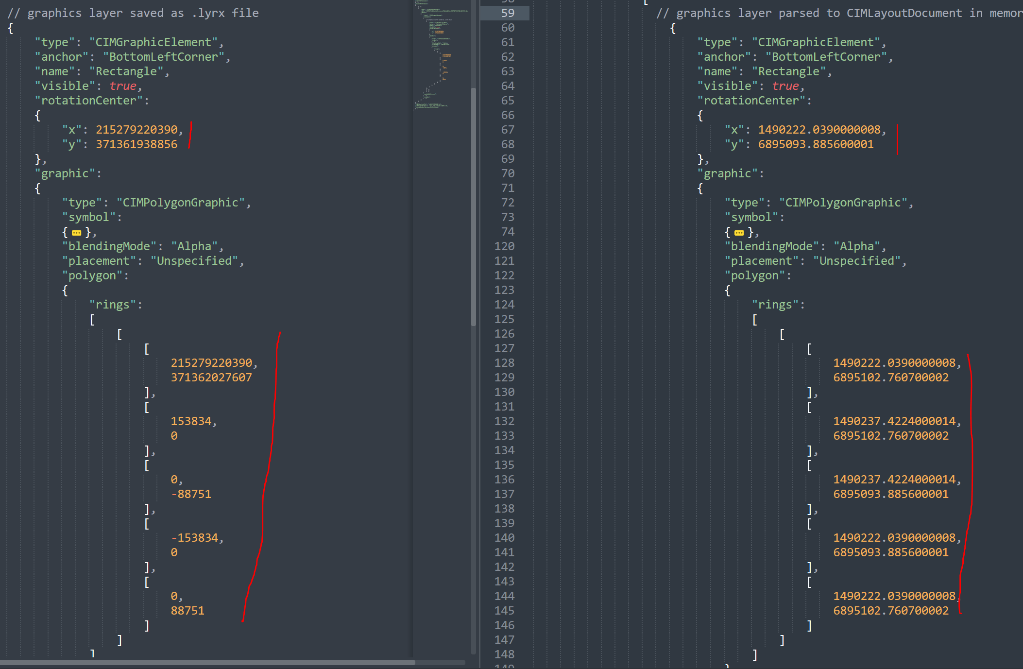

This two are probably just some parsing errors but the last one just does not make any sense to me. If I get the CIMLayerDocument in memory the CIMElementStorage object exists, but somehow the coordinates of the different graphic geometries are manipulated/odd in comparison when I do a proper save to .lyrx file.
var layerDoc = new LayerDocument(graphicLayer);
// BUG: The resulting geometries within the CIMElementStorage have completely different geometries, see image below
// geometries are broken
var cimLayerDoc = layerDoc.GetCIMLayerDocument();
// geometries are ok
layerDoc.Save("C:\\temp\\temp.lyrx");
Left the geometry saved as .lyrx and right the in memory create CIMLayoutDocument. The source is exactly the same.
Any explanations or hints on this would be appreciated!

Weird. I wonder if the coordinate system used between both formats is different?
marco_vertigis
The spatial reference is actually the exact same. Its the same source map and the same source geometry.
RichardDaniels
MVP Regular Contributor
If you found a repeatable inconsistency, I would encourage you to place a bug report with Esri. That is the only way to get this addressed. The bug is either in the help documents for the LayerDocument(graphicLayer) object OR an unexplained behavior in the CIMLayerDocument object.
