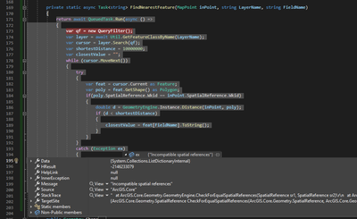

I'm seeing exactly the same thing in pro 3.1.0, two features with the same spatial reference. The layers have the same spatial reference, I check they have the same WKID in code just to be sure, still fails.
Feels like a bug in the code of the geometry engine  " at ArcGIS.Core.Geometry.GeometryEngine.CheckForEqualSpatialReferences(SpatialReference sr1, SpatialReference sr2)\
To me its feels like the code might be they are checking that they are the same instance of spatial reference object, rather than that they are the same?
My workaround therefore was to use the SR of on of the layers to rebuild the geometry of the other. In my case I used the SR of the polygon layer to create a new point
var point = new MapPointBuilderEx(inPoint.X, inPoint.Y, polyLayer.GetDefinition().GetSpatialReference()).ToGeometry();
