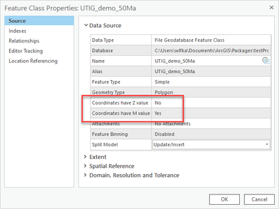

Strange, both feature classes you sent me have 'No Z values'.   That would mean that z-values got added to the geometry.  Can you double check your feature classes ?  I used v 2.8.2.
KarenMeinstein
Something was weird was going on with the data I was using (which was different that what I sent you).  It seems to be working now.  Yay!
