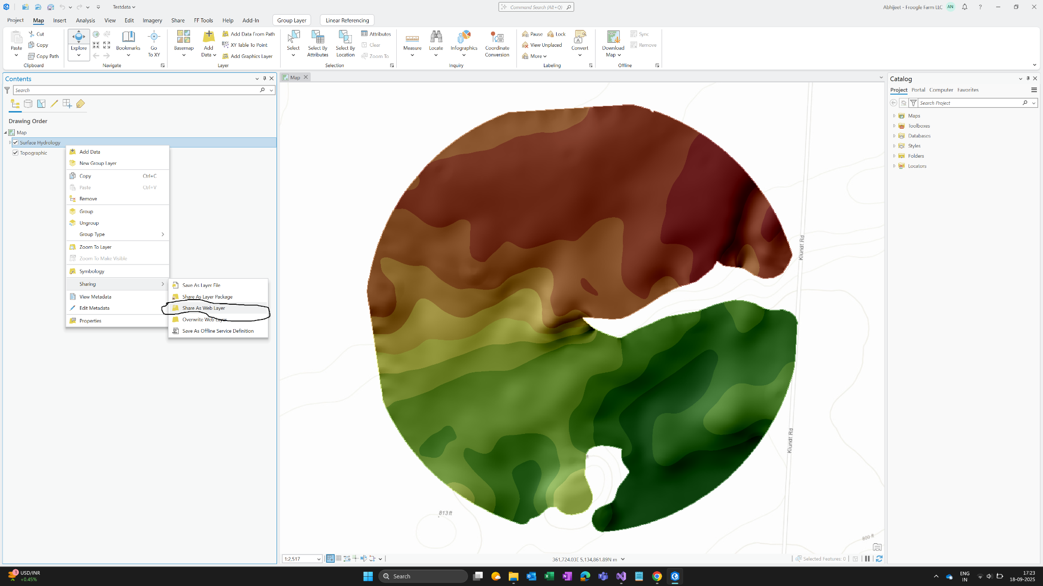

Hello everyone,
I’m trying to replicate the “Share As Web Layer” functionality (shown in the screenshot) using the ArcGIS Pro SDK.
Here are my questions:
  1. Is there a direct API in ArcGIS Pro SDK to share a feature layer (or raster layer) as a web layer to ArcGIS Online / Enterprise?
  2. If not, is there any workaround through the SDK that mimics the desktop workflow (right-click → Share As Web Layer)?Share as a web layer.png
Any insights, documentation links, or code examples would be very helpful.
Thanks in advance!
@UmaHarano , @Wolf

UmaHarano
@AbhijeetNandeshwar1
I am not aware of a way to accomplish this with the API.
I recommend posting this request in the Pro ideas site for the API support.
Wolf
by Esri Regular Contributor
I am trying to find the script / GP tool that can be used to 'share' or 'publish' a feature layer as a web layer.  Until then you can at least present your users programmatically with the 'share feature layer as web layer' dockpane using this snippet:
IPlugInWrapper wrapper = FrameworkApplication.GetPlugInWrapper("esri_sharing_SharingAsWebLayerPaneBtn");
if ((wrapper is ICommand command) && command.CanExecute(null))
            command.Execute(null);
AbhijeetNandeshwar1
Hello @Wolf ,
Thank you for your insights. I tried this workflow, but I want to autopopulate the Geoprocessing tool through code. It doesn’t achieve the desired result.
