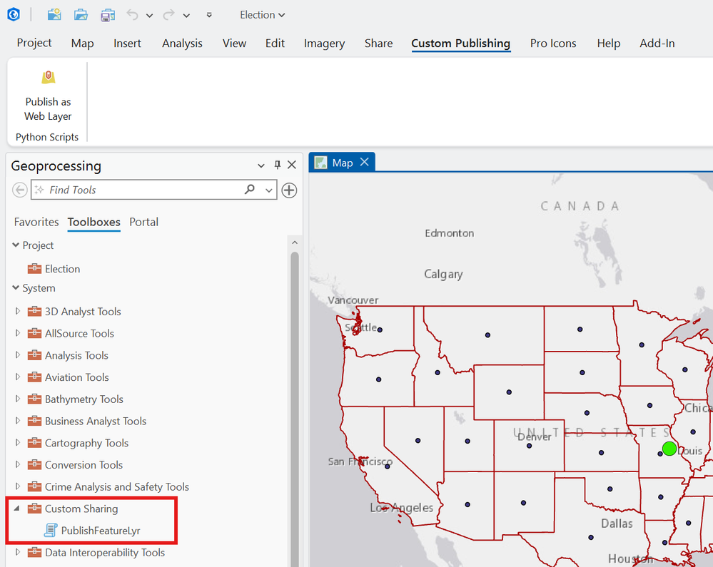

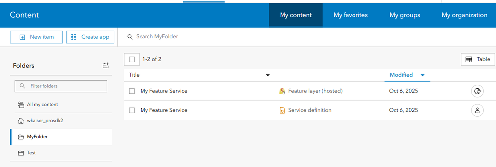

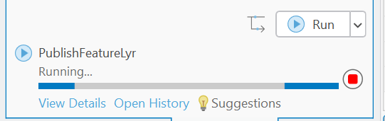

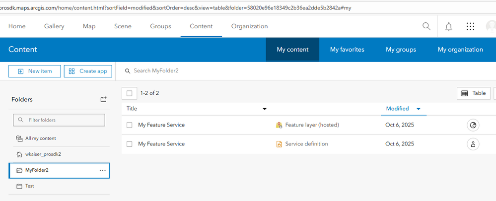

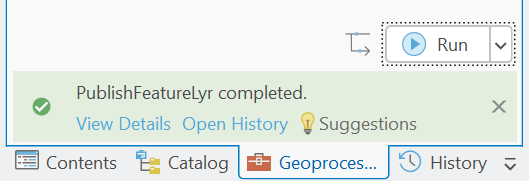

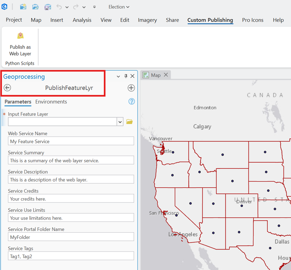

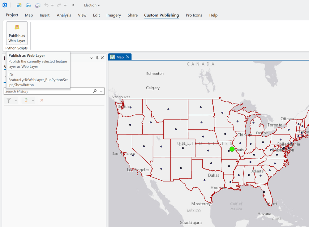

I attached a sample ArcGIS Pro Add-in project that includes the python script used to publish a feature layer as a web layer.   Because the code is using ExecuteToolAsync to run the python script the script can utilize the existing ArcGIS Pro portal connection eliminating the need to passing user name/ password to the script.
here is the sample's readme:
  1. This solution file includes an example python script named MySharing.pyt which is included as 'Content' (Build action) in the add-in.
  2. The python script is stored in the .\Toolboxes\toolboxes folder and when this add-in is loaded in ArcGIS Pro the python script is available a script tool under the ArcGIS Pro Geoprocessing toolbox.
  3. You can run the python script from the Geoprocessing toolbox as shown here.
    4. You can also run the python script from code as implemented in the 'Publish as Web Layer' button under the 'Custom Publishing' tab (RunPyScriptButton.cs).
