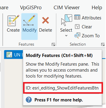

would like to activate:
1) Create feature
2) Modify feature, and in particular the Move option
3) Delete feature
tools under the Edit tab, programmatically for a specific feature layer, and subscribe to the edit completion events.
Is this possible in arcpro sdk?
2 Solutions
GKmieliauskas
Hi,
Use GetPlugInWrapper Method—ArcGIS Pro. To find tool reference id move mouse over the tool.

Hi,
Gurunara
Works...
