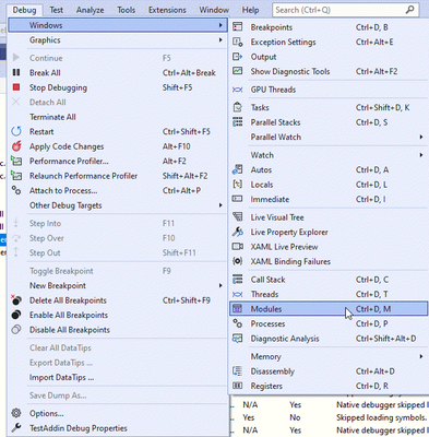

UmaHarano
@Vidar
Can you please check the version of System.Configuration.ConfigurationManager that ArcGIS Pro is loading while running your addin?  You can see this version from within Visual Studio while you are debugging the addin.  See screenshot below. Sort on the Name column.
The version of the System.Configuration.ConfigurationsManager NuGet you are referencing in your addin should match the version that ArcGIS Pro needs.  Check out this post on Esri Community - a very similar issue to yours was posted here.

UmaHarano
@Vidar
Vidar
This appears to be the issue - so I have installed version 8.0. Nuget packages of what it thought was missing - however it needed version 6.0 - as the Module window (can only be seen when debugging) shows that version 6.0.x seems to be the versions of dlls Pro is using under the hood.
