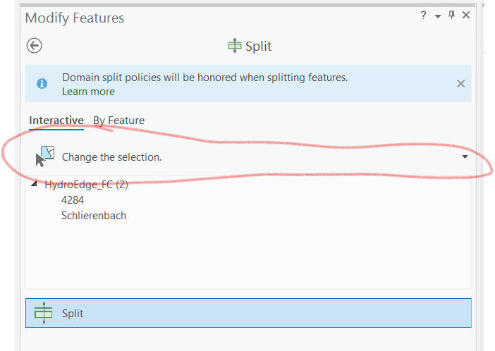

I created a custom Tool (Sketch) with a embeddable control and placed it in the esri_editing_CommandList. That works fine so far. Now I'd like to build a similar tool like the split tool. The split tool opens a embedabble control with a select tool inside. Is it possible to insert the existing select command into embedabble control or do I have to write new code from scratch for that?

NarelleChedzey
Hello,
Unfortunately we don't have any public controls or templates that provide the UI and behavior that you see within the Editing tools such as Split with regards to the selection tool dropdown and TreeView showing the selected features.
You can however certainly add any of the selection tools (rectangle, lasso, etc) into the UI yourself by attaching it to a UI wpf element such as a button.
I will try and work up a simple example and post here.
Regards
Narelle
