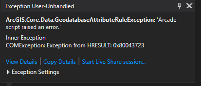

Sometime, for some reason, I got and error in the code saying the Arcade Script raised an error. That is fine. But the error does not say which attribute rule.

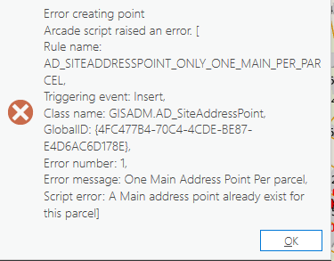

When I do the manipulation by hand in ArcGIS Pro, I got the same error, but it is detailed some thing like this:

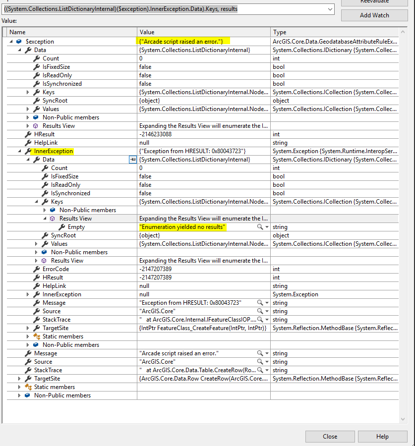

I try browsing the exception to get detail to find the rule name that generate the error but I can' t find more information except the "Arcade script raise an error" message. I  would like to have the detail shown in the above image.
Does anyone have an idea if that information is available with the SDK ?
Here the exception object
Thanks
Sylvain
UmaHarano
Hi
Arcade parser is not currently available through the Pro SDK.
Uma
