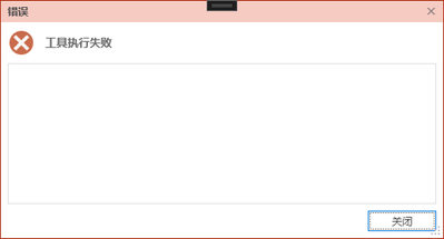

I am using arcgis pro sdk. After I called the tool, the tool failed to run, but the prompt box was blank. How can I get detailed information?
// 获取错误信息
if (results.IsFailed)
    await QueuedTask.Run(() =>
        Geoprocessing.ShowMessageBox(results.Messages, "工具执行失败", GPMessageBoxStyle.Error);

Hi,
It could show that your tool was not started for not valid parameters or invalid tool path/name. Try to use GPTool Execute Event Handler to get more information about tool execution.
