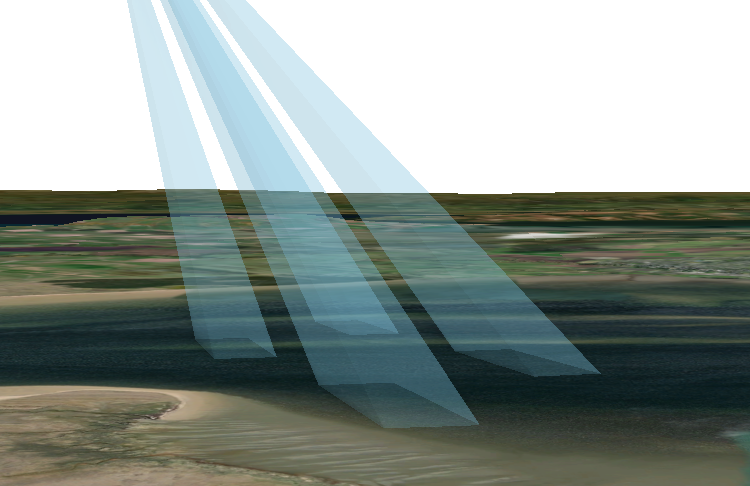

So i have these multipatches that I'm rendering and they can be of varying lengths in my AddIn.  Attached is screen shot.  I would like to be able to determine if any of these multipatches intersect the ground and if they do I would like to know the points the points of intersection..  What would be the best tool to use to do this in ArcGIS Pro 2.5? If there are various methods, what are the advantages/disadvantages of each?  Thank you.

It looks like they want to see where ‘view frustums’ from airborne imaging devices intersect the ground. We don’t have a ‘IntersectMultipatchWithSurface’ tool but we do have ‘Intersect3DLineWithSurface’. If the user models the 4 corners of a view frustum, or its center, as 3D polyline features, they can get back the points of intersection between the lines and the surface.
Multipatch frustums
