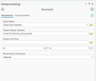

I have solved my problem by using Rescale geoprocessing tool.
GKmieliauskas
Hi,
You can use Resample geoprocessing tool. Tool name "management.Resample"
Muhammadkhalid
Thanks for the response but its not working for me. I have used Resample geoprocessing tool in arcgis pro for testing as you can see I have changed x,y values for output, but the output is also the same width and height of input
Muhammadkhalid
