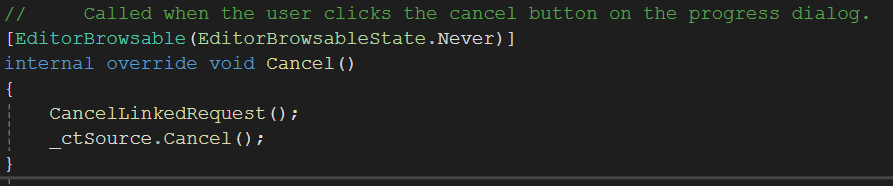

Currently my referenced scenarios have to call methods in the MCT process, i.e. they have to be called in the QueuedTask, but some of the methods take a long time to execute and I want to be able to cancel them manually, but I've found that CancelableProgressorSource.Cancel() seems to be available only in the Cancel button of the interface, which I'm not so sure about.
I was wondering if esri could provide a definitive answer as to whether I can do a manual cancel via code for the specified executing MCT method? If so, could you provide some sample code?

Check out this community sample that illustrates how to use ProgressDialog and CancelableProgressorSource to accomplish what you need: https://github.com/Esri/arcgis-pro-sdk-community-samples/tree/master/Framework/ProgressDialog
Here is a small code snippet that highlights this:
//on a Pro button click on the ribbon
protected override async void OnClick()
 var pd = new ArcGIS.Desktop.Framework.Threading.Tasks.ProgressDialog(
        "Processing...", 10, false  );
 var progressorSource = new CancelableProgressorSource(pd);
 progressorSource.Max = 10;
 await QueuedTask.Run(() =>
    if (progressorSource.Progressor.CancellationToken.IsCancellationRequested)
            return;
    //Do business logic
    progressorSource.Progressor.Value += 1;
progressorSource.Progressor.Message = "...";
