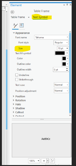

Hi,
I'm using the Table Frame functionality in the ArcGIS Pro application where I need to set the Text symbol part that appears when we go to the Table Frame properties table, beside that there is one tab "Text Symbol" that I need to access through the backend using C#.
Is there anyone who knows how to do this or can provide the code snippet ?
