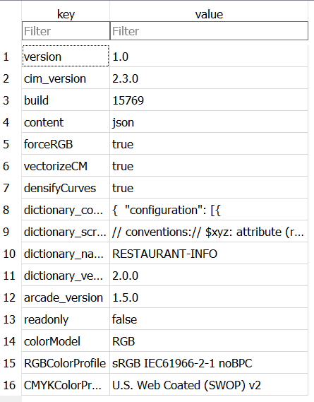

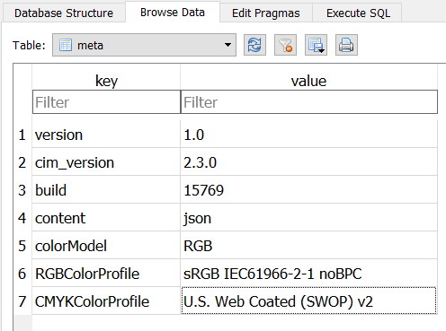

When I create one with StyleHelper.CreateStyle, it lacks some rows needed by the dictionary renderer in the meta table:
The  ProGuide Custom Dictionary Style says to just copy the Restaurant.stylx, which has more in the meta table:
If there's currently no tool for creating these stylx files, could I just programatically add these rows?
Are these additional rows the only thing that's needed to make a mobile style file behave as a dictionary renderer?
