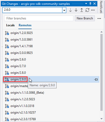

You can go to "Releases" (on the ArcGIS Pro SDK Community Samples GitHub home page on the right side below the 'About' section): Releases · Esri/arcgis-pro-sdk-community-samples (github.com)
Go to the release you want to work with and download (under assets) the sample data you like to work with and the source code.
If you clone the repo in Visual Studio you can change the GitHub branch to the release you like to work with, however, you will still have to download the corresponding datasets from the Release (see above).

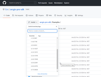

For the API Reference help you can just replace the '/latest/' in the help URL with the version you're working with for example:
https://pro.arcgis.com/en/pro-app/2.9/sdk/api-reference/index.html#topic1.html
Examples snippets are available by cloning this repository: Esri/arcgis-pro-sdk: ArcGIS Pro SDK for Microsoft .NET is the new .NET SDK for the ArcGIS Pro Applic...
Unfortunately the wiki with ProConcepts, ProSnippets and ProGuides is not versioned.
Correction: you can clone the wiki as well, but you have to read the md pages using a browser.  The viewing experience is not very good.
