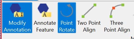

sudhansuMishra
Thank you for sharing ,
But I am facing an issue while activating another tool previous one is deactivate . I want to set activate both tool at a same time .
And also want they both are working
