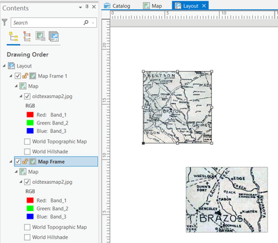

KirkKuykendall1
Keep in mind a project can have zero or many Layouts.
A layout can have zero or many MapFrames
Each MapFrame references one (and only one) Map.
A Map can be referenced by more than one MapView, each with a different extent.
To illustrate this: Add a layout to the project and add 2 MapFrames, both pointing to the same map.
Activate one of the MapFrames and zoom to some different extent.
Run code to show how the same Map can is referenced by two different MapViews each having a different extent, via MapFrame.GetMapView().
